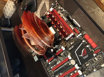

Look what I found. Two brand new Thermaltake V1 Coolers from like 2007 haha.
https://www.newegg.com/thermaltake-cl-p0401/p/N82E16835106102
I was able to mount it on my old AM3 board, which means it should work on this new one also, just like the FX AM3 cooler worked.
Below is a pic of it mounted on my ASUS Xhair V AM3 board.
I'm going to check temps of the stock FX cooler and compare. The good news about this cooler is it exhausted towards the rear exhaust fan.
P.S. No idea why my pictures are always rotated when I upload to this site. I don't have that issue elsewhere.
Unless the cooler is the clip on kind you would need to adapt the mounting mechanism to go from AM3 to AM4. The mounting holes have a different pattern.
Yup, it's clip-on kind :D
With the stock FX cooler I was getting 39-40C idle, and 56C load with P95 Small FFT.
With this V1 cooler it was 32-33C idle and 48C load.
Not bad. The downside to this V1 cooler is it has a potentiometer. I'm running it max. It's not super load, but it's unacceptable for me. I'd be fine with it during load/gaming. It's a 3-pin header and a separate variable resister (knob) for fan tuning.
Man... the 4-pin design is so much more acceptable. I'm wondering if I can handcraft something. So there is a 3-pin header, and the other is just two wires with a potentiometer at the end.
I turned down the knob to a fairly quiet level and temps only went up 2C during load.
