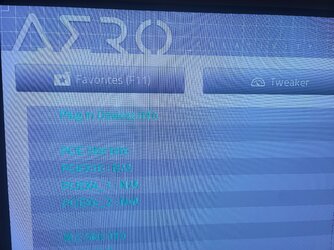

Upon starting backup the previous no video signal symptoms returned.
Flashed to latest Beta Bios from Gigabyte Support Site Bios Dated June 6th 2024
Theres a quick snapshot of the BIOS Screen Plugin Devices PCIe
Its easy to determine the 4080 GPU is not detected.
in the primary PCIe x16 slot i installed a PCIe x 1 Network adapter and it was detected by the bios 1st boot.
installing the 4080 back in place the bios again is as above with N/A nothing detected.

System was running perfect Yesterday and This Morning !!
Did a manual Shutdown to install some G 1/4" pass thrus in the chassis !!!
