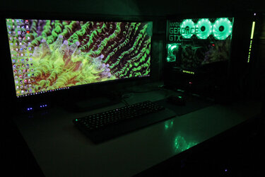

This wasn't a totally new build, as I rehoused my existing main system into this case. I need to update my sig some time. Out went the Corsair Air 540, which wasn't the problem, but the watercooling I put in after. It really kept the temps down, but I couldn't reduce the pump vibration enough, and I also had a residue problem in the loop needing a deep clean. Neither of these jobs were likely to be quick, so I moved all the stuff over to an In Win 303 NVIDIA edition. I debated going for the standard one or not, and the nvidia one won purely as I like green front panel more than blue of the standard.

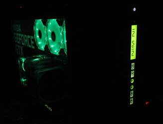

The fan at the rear is the one that comes with the case. The upper trio are Corsair HD120s. It is a plus all the fans are the same shade of green, but the down side is that isn't the same shade as the GEFORCE GTX illumination, which is a lighter shade, and does match the front panel as shown below. I don't think there is any easy fix for this.

The big question is would green cables enhance the build or not. The smoked glass makes back cables almost invisible as long as I don't add any more lighting. Even the Noctua brown fans don't look bad with the green lighting.
