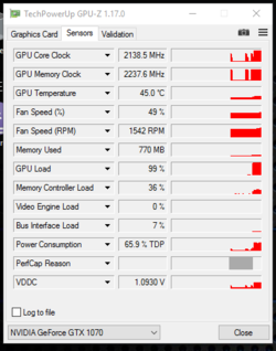

Nebulous
Señor Senior, Senior
Oct 11, 2002
The Empire State
I have yet to see a 1080 or 1070 that will volt past 1.063 on any of the manufacturers stock bios. Most limit it at 1.063 and it will fall back to 1.050. My EVGA 1080 FTW Hybrid is the exact same way. Peaks at 1.063 falls back to 1.050.
Mine hits 1.093v with ease. I can show a screenshot if you like. I use MSI Afterburner and MSI's Curve posted here: http://thepcenthusiast.com/how-to-overclock-your-geforce-gtx-1070/
As witchy posted: no balls no glory ;)
