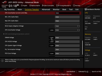

Did you try setting the max CPU/Cache cuurent to max?
So what number did it populate for max current, not sure we're talking the same setting.
it's the one highlighted in this pic
I believe it was 255.75? I left for work or I’d check for sure.. the other power limits were 4000 something
Cpu current capability 170%

You really shouldn't need to mess with the other settings in the DIGI+ section, at least not for this type of OC

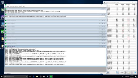

5.0 GHz @ 1.25 V mem 4266 CL19-19 running P95 no offset for AVX after the fisrt 15 mins or so is when it starts to get heavy but you can see it's running at a decent temp currently but it'll have spikes into the 90° range
