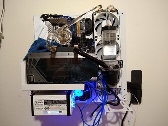

Thank you for all the responses. Here it is wall mounted running a leak test. This is my first time hardlinining, and I'm going to redo the tubes with more practice. Heh, the one black tube is because apparently I the wrong color (fortunately, only one stick of it and it was really cheap on sale). So, I can practice more with that :)
I plan to have the PSU cables individually sleeved (hoping to rope in some help for that). And planning to use UV Blue fluid inside a lot more clear pipes going just horizontal and vertically (not the direct angles they're doing in that pic).

Looks killer man! Well done and nice and tidy other than needing a couple zip ties. What did you end up getting for WC parts? Also, totally personal preference but this may look better with the video card mounted horizontally.
What CPU waterblock did you end up using? It looks like your loop goes in this order: pump>GPU>CPU>Rad>res>pump. It appears that the CPU block has some sort of jet plate on it, and that possibly it will perform substantially better with the water flowing into the hole that is more in the middle of the block, and out of the other one. You could rotate the block 180 degrees to achieve a similar orientation to what you have now.
It appears to be the Barrow Aurora. According to their website, it is indeed optimal to have switch the inlet and the outlet from their current configuration. http://www.barrowint.com/plus/view.php?aid=1183. Of course one might also think that the chiplets (at least with 3000 series) are located in the lower area of the package and it's better to have the water flowing directly onto that area, but I think the jet plate may have a more desirable effect.
That looks like a really small rad. What is that, a 240? If so that 3080 is going to overheat it. Your CPU will overheat with that small of a rad. For a 3080 you should ideally have a 360 and a 280 or more.
Thank you all very much for the great comments! I ended up finding a 2080 hydro copper on ebay for a good price, so that'll be my GPU for a long while. Now if 5900x's would get back in stock. I bought a cheap cpu to use until I can swap it out.
It is a 360 mm rad (Black Ice Nemesis 360GTS) and so far has been doing fine. The fans are EK-Vardar EVO 120ER D-RGB. I had intended to get the Black Ice 360GTR but it wasn't in stock. The GTS is a thinner rad. Now, I'm a little concerned about sound. Would the GTR be louder? Right now, the only thing you can hear is the gentle hum of the pump (at 25% according to Q-fan), and I like how quiet it is (hmm... how can I silence the pump? :)
@Zerileous thank you so much for noticing my mistake on the CPU block. You're quite right. It's the Aurora and in/out is backward. Fortunately, these pipes were temporary. My plan is to change it to pump>CPU>GPU>Rad>res>pump. I'll have the pump go straight into the top port with the new layout.
