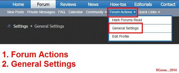

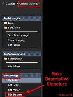

You need a signature...
...How to put up Sig at OCF. Got to find where SIG is located now that the forum has changed a few months ago.
Looked thru the pages of thread and could not find WHAT 600watt power supply you have. Be it cheapO or reputable. If we knew what it was...most likely it will be fine along with a single 280 video card.
RGone...ster.
How to Make Signature new forum style for non-mobile users.
