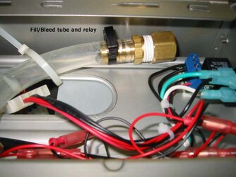

Looks good! So you will have 2 shrouds? If so, very nice. Avoid the 90 degree pump elbow like the plague, will kill flow rate. Avoid all 90 degree fittings if possible. I disagree with the plastic hose clamps, they SUCK! I used them once, stuff leaked. Use the metal hose clamps, much better and more secure. Go to home depot and get a 1/2" barb with threads on the top so you can cap the "t" line, here is a pic of mine:
Thanks for the help guys. I'll get the proper fittings. I'm planning on using metal hose clamps unless I run into some unforseen problem with them. And yes, I will be using two shrouds. Seems like the best way to go.
i was talking out of expierence (sp?) because i a metal hose clamp and the area around where the screw is would get moist because it doesn't "clamp" that little area. I now use zip ties and they work fine.
