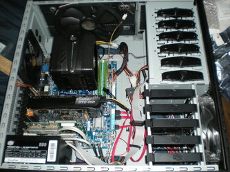

Heatsink
Nice Joe, only comment I have is you forgot to mention putting the heatsink compound on the heatsink before putting it on the cpu, otherwise you could have a french fried cpu :) I did see that there was some on the heatsink and cpu in your post on it.

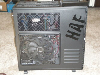

Before I got Cooler Master's HAF 932 full tower case, the full tower I had did block air in it, parts of the case was very warm.
I don't know about all full towers but I can say the HAF line of cases are very cool and no blocking of air in it.
