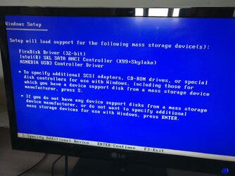

when installing WinXP I have to add drivers for SATA AHCI, FIRADISK and USB3. (Ikdybych only add to the SATA setup to dont see my drive, it does not matter, I do it all the time)

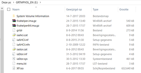

This is what is on de USB. The 2 unpakked files + XP.iso. The USB is prepared with that RMtool.
I added the 3 drivers in the installer, as you can see.

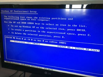

I want too install it on the C: drive, wich is an Samsung EVO SSD.
I select "no changes".

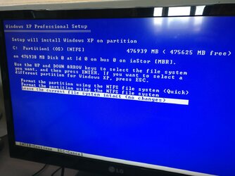

And after a few seconds I get this.. What am I doing wrong? Can you help me?

I seem to remember also having a similar problem initially and I am trying to remember how I fixed it. Be sure to do this:
You *DO NEED* to go into BIOS and setup your BOOT order and have NON-UEFI Windows XP installation media first, and drive you are installing Windows XP to second. Every other drive disabled, if they were not already disconnected from the computer, which they should be.

Are you using a modified Windows ISO which you used before to install it somewhere else, you know, modified with nLite to include AHCI drivers... just making sure.
