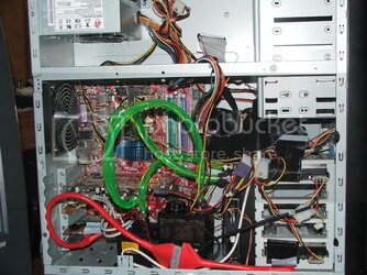

My case as it looked early yesterday, before installation...

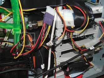

You can see the radiator is getting the hot air left over from the hard drives...

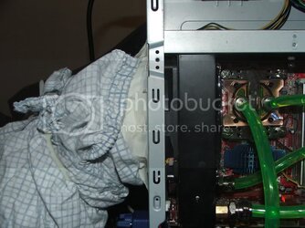

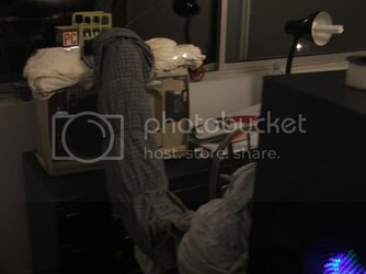

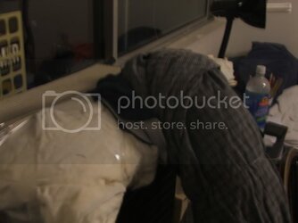

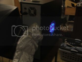

As you can see from the pics below, the airconditioner will blow air into the radiator intake, to direct the flow, i plugged up most of the airconditioner output, and use ducting to make a channel into my comp.
I needed some insulation, so i did some heavy ghetto modding. the cloth on the sides of the air conditioner is old curtain, and the rest consists of an old sheet, a pair of pajama pants, and some boxers (all ripped up)...
Attached to the airconditioner by tape (and magic)...
attached to the case by twist-ties, tape (and magic)...

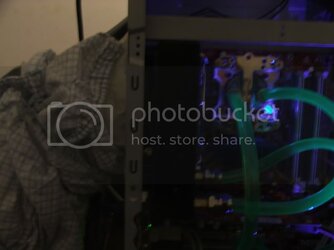

You can see how the cool air flows right into the radiator

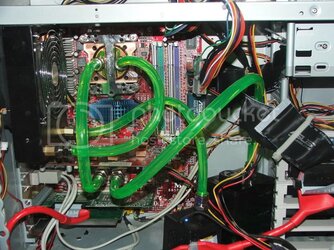

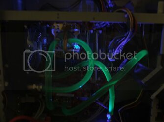

My "new" system, considerably more spread out, and infinitely colder

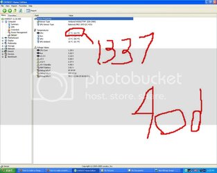

I'm very happy with the temps. Prescott 3.6ghz @ 4.25 is ideling at 17c SEVENTEEN CELCIUS! pretty sweet, and under load it barely scratches 35c

glam pics!

If nothing else, the water/ambient temps within my case are down by about 20 degrees, and that more than enough for me, not to mention my cpu temps, and to a lesser extent, the gpu temps.
since the entire case is receiving the same temp, there shouldnt be condensation. (could be wrong though)
Theres a tiny bit of barely feelable condensation on the tube from the rad to the block, but nowhere else. like jcll said, the whole case is cold enough that there isn't enough temp diffrence for condensation to occur

pic of temps on my rig, the aux is the water temperature, but they sometimes (rarely) go below 9c
