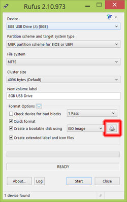

There are several excellent freeware tools available to create a bootable Windows 7 USB. For example, Rufus - a USB installation media creation tool: https://rufus.akeo.ie/
Leave the default settings as they are in Rufus and:
1. Select Device [target USB]
2. Make sure the box next to Create a bootable disk using is checked and that ISO image is selected and click on the disk icon to browse to Windows7Updated.iso > Open
3. Click on Start > OK
