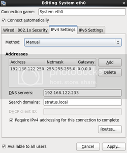

Step 1: Setup your networking
You will want to setup your network with something similar
to this

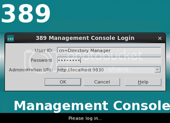

Step 4: Working with the 389-console
Now that the server is running, run the following to launch the graphical interface:
Code:
389-console
Enter the following:
User ID: cn=Directory Manager
Password: <your password>
administration URL: http://localhost:9830
Click the + sign beside your hostname, and then again on the Server Group to reveal the Directory Server option. Highlight it, and click the “Open” button.
You will be greeted by this screen:

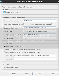

Right click on the “userRoot” and click “New Windows Sync Agreement”. You will be greeted with the following screen.
Enter your information. This is mostly aesthetic, as this only affects what the directory server displays for the sync agreement.
After clicking next, fill in the following information:
Windows Domain Name: stratus.local
Select Sync New Windows Users, Sync New Windows Groups
Domain Controller Host: w2k8-ad.stratus.local (or the FQDN of the Active directory server
Bind as: cn=Administrator,cn=Users,dc=stratus,dc=local
Fill in the password box.
NOTE: you do not have to bind as Administrator, but this requires your Active Directory system administrators to provide you with the appropriate “cn=” users.
NOTE 2: I have run into problems with users who have no Surname having some of their group memberships stripped in a domain which has been upgraded from 2000 -> 2003 -> 2008. If you experience this in your TEST environment try setting the bind user to a non-privileged user and then setting their security access to "Replicating Directory Changes" to allow (This is found by enabling Advanced Features, then right clicking on your domain and clicking properties and then going to the security tab. If your user is not in the list, add it and then grant it the permission to Replicate Directory Changes
After clicking next, the system may pause for a moment while it tests the information you have provided. If it is successful you will see a summary of the sync agreement. At this point you will be able to sync users and groups but NOT passwords.

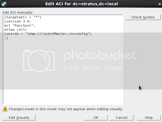

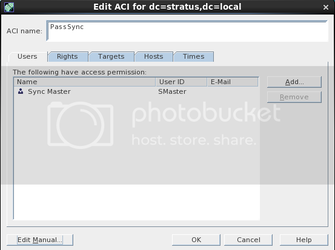

Step 7: Setup an ACL for PassSync
In the Directory Server window, click on the Directory tab. Highlight your domain (in this case its' called “stratus”), right click and select
“Set Access permissions”. NOTE: this can also be achieved by pressing ctrl + L
Select “New” from the right hand menu. In some cases you will see a the following (see the screen shot directly below).
Enter an appropriate ACL name and then click “Edit Manual”. Replace the contents with the following:
Code:
(targetattr = "*")
(version 3.0;
acl "PassSync";
allow (all)
(userdn = "ldap:///uid=SMaster,cn=config")
Click “Ok”. You should now see a “PassSync” option listed in the ACL list. Click “Ok” to close that screen.

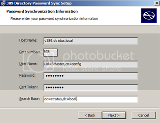

Step 10: Install the PassSync service on the AD Server
Download the PassSync and install it on the Active Directory server. You will need to fill out the form before PassSync will start syncing passwords with your directory server.
**NOTE: This step can be misconfigured and the users and groups will still be imported properly without passwords
**NOTE 2: the log file for PassSync can be found C:\Program Files\389 Directory Password Synchronization\passync.log

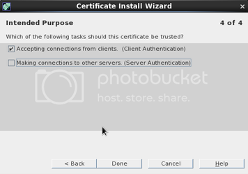

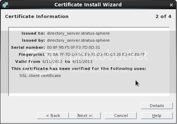

Step 11: Copy the Server-Cert to Windows AD and import it
The server cert you just created on your 389/ldap server will be located /etc/dirsrv/slapd-389/servercert.p12. Copy this over to the Windows Server and import it with the following commands:
# run this on the w2k8 server in C:\Program Files\(Red Hat| 389) Directory Password Synchronization

Open up the directory server from the 389-console.
Select "Manage Certificates" under the "Tasks" tab
Click on the "CA Certs" tab and click "Install.."
In this example, I am simply catting out the cert so that I can paste it into the program. If you wish you can also select the file by browsing to it.
After you have pasted the file, you will be greeted by the following summation screen:
Continue clicking next, you may read the screens if you wish, but no action is required until you get to the following screen:
In my case, I am not wanting other servers to authenticate against my Directory Server, so I made sure that I only checked "Accepting connections from clients"

2. I can not sync passwords. The passync.log on WinDC gives every time
Code:
12/11/12 15:03:04: PassSync service running
12/11/12 15:03:04: No entries yet
12/11/12 15:03:04: Ldap bind error in Connect
	32: No such object
12/11/12 15:03:04: Can not connect to ldap server in SyncPasswords
:( Error log at server only​
Code:
[11/Dec/2012:14:45:05 +0100] NSMMReplicationPlugin - Beginning total update of replica "agmt="cn=ISE_Mitarbeiter" (darona:389)".
[11/Dec/2012:14:45:06 +0100] NSMMReplicationPlugin - Finished total update of replica "agmt="cn=ISE_Mitarbeiter" (darona:389)". Sent 12 entries.
First I thought, it's a password problem by certificate database at passync (I've given an empty password), but after re-creation with password same error occours.
What I've forgotten?

As to your first question, the OUs will sync if you have created them ahead of time. This is why I have included the section on dumping your AD schema and loading it into the Directory Server. Once the schema is in place the OU will sync normally.
As to your second question, the error message you posted seems to indicate that the ldap server is not available or has been mis-entered in your SyncPasswords area.
Can you ping it?
If so, can you run a port scan to make sure the 636 port is open?
If it is open, you can check /var/log/audit/audit.log to see if SELinux is denying the interaction
Also note that PassSync only replicates passwords which have been changed AFTER it was installed.
Therefore you have to push a global password reset after you are sure the sync is working. So for this I setup a test user so that I could constantly change the password and verify that the password was showing up in the 389 server

I found something other: My SMaster-account:
Are you sure, that at passsync configuration, smaster should be cd=smaster,cn=config ? After changing my smaster into uid=SMaster,dc=domain,dc=domain,dc=...,dc=de I didn't become an error at logfile:

Ok, that is it. But now if I changed a password of a user, the log file gives me another error, maybe of changing the user-account credentials?
Code:
12/12/12 11:20:17: Ldap error in ModifyPassword
	50: Insufficient access
12/12/12 11:20:17: Modify password failed for remote entry: uid=wang,ou=Mitarbeiter,ou=...,dc=...
12/12/12 11:20:17: Deferring password change for wang
Stratus_ss
Stratus_ss
Overclockix Snake Charming Senior, Alt OS Content
Jan 24, 2006
Ontario Canada
Yes.
You dont have to have all of that but you are right there was an error in the screen shot, that screen shot has been removed. Good catch and sorry for the confusion. I actually dont know where the proper screen shot went, when I was taking screen shots I had already set things up and I was kind of rushing through
As for your other error, I did not encounter this error in the 3+ months of QA testing, I am not exactly sure where the problem is

Thanks for your helpful guide, i'm having a strange msg error about the certificate
when i type this command cacertdir_rehash <dir where certs are stored> i get this :
--> cacertdir_rehash
unable to load certificate
7653:error:0906D06C:pEM routines:pEM_read_bio:no start line:pem_lib.c:647:Expecting: TRUSTED CERTIFICATE
i tried to fix the problem with this http://www.schalley.eu/2010/12/30/openssl-certificates-tips-tricks-der-crt-cer-pem/ but it didn't work :eh?:
I'd appreciate some help.
Stratus_ss
Stratus_ss
Jan 24, 2006
Ontario Canada
Can you elaborate on what exactly you did to create the cert?
Perhaps some insight into the process will help track down an answer

We currently are running a 389 directory that was setup in 2011 by a former sysadmin. We're trying to slowly move to AD.
When I try to export the key and run certutil on the windows server, we do not know the key password. Trying to generate a new key on the 389 server causes issues. We've cloned the server and running it in a dev enviroment.
When I try to run command I get invalid password. Is there anyway to resolve this?
# certutil -N -d . -f /tmp/pwdfile
Invalid password.
