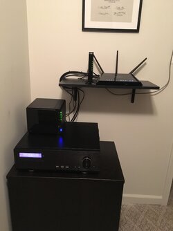

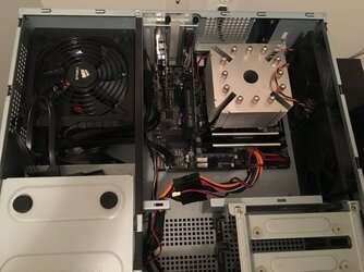

pics:
About the passive cooler. I did this for nothing else other than noise, and I believe the proximity of the 120mm case fans is sufficient to keep it cool enough. As a totally unrealistic test, I ran Prime 95 v29.3 (AVX enabled) and let it run for about 10 mins. Max temp was 89C; quite hot, but in limits. in real world loads sending files and transcoding, I've not seen the CPU over 65C. Since the case only has 2x120mm 1200rpms fans, it's very quiet. i only hear the HDD activity sometimes (which will go away when i swap it for an SSD).

after getting everything to work, I made the server full headless (as seen in the pics) and I just RDP into it for any configuration or tweaking I may need.
