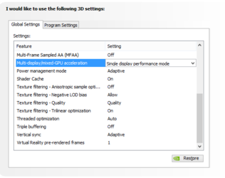

Sorry, i forgot to mention that YES i also turned on adaptive option for vsync in nivida control panel. It does work bit better, but i still get those stuttering frame rates in certain part of GTA V. I hope it isn't also because of updates, cause far i know the game should be updated.
Other then that i think its just my monitor not being able to catch up with my GPU and need to upgrade i guess. PC.PNG
Im going to guess part of the problem then is vRAM use. The 970 only has 3.5GB worth of 'fast' vRAM. You are playing on Ultra(ish) settings. Are you using over 3.5GB of vRAM? You can check in the game settings how much its expected to use, and confirm in MSI AB how much it is actually using. Get that value below 3.5GB and I would imagine the stuttering will go away.
EDIT: The odd part is you had a 760 and it didn't do it on the same settings... was it the 4GB model you owned? Regardless, I would look at the GTA settings and see what it is projecting your vRAM use and then check AB for real use.
EDIT2: Also, change your power management mode to performance and see if that helps (one change at a time so you know what did it).
