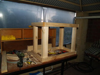

Building the frames for each end.

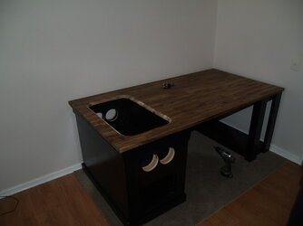

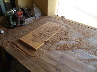

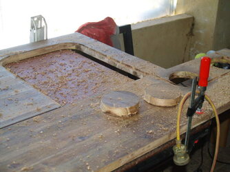

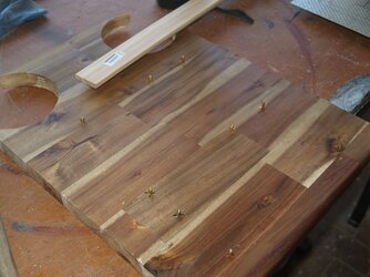

Cutting out the area for the clear panel to sit. I screwed down a piece of board roughly the size I wanted, then ran around this with a router to get the step for the acrylic to sit on. I then used a holesaw to cut the 4 corners & finally a jigsaw to cut away the rest.

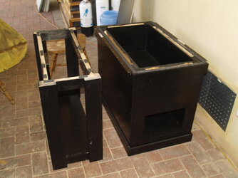

Bases mostly completed.

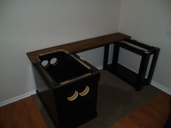

Test fit in the room.
Looked good, I ended up reversing the positions of the cabinets though, for a reason that will be shown shortly :)

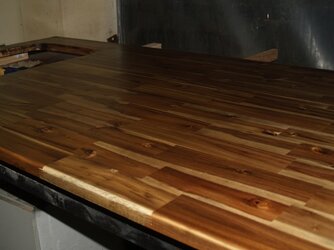

Top was then removed again, joined properly, sanded & oiled up.

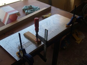

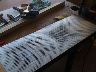

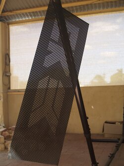

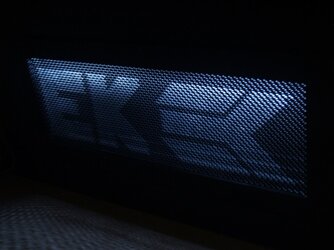

The radiator sits down in a separate section under the motherboard. I decided to make up a cover for it using perforated steel sheet. I drilled out some of the holes slightly larger to create a pattern. I was pretty happy with the end result.
Painted.
Installed with LED lights.

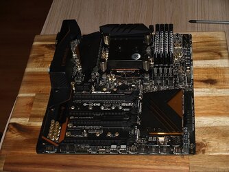

With the desk now complete, it was time to start on the computer. This is the motherboard tray. I don't have pictures the underside, but it sits on small legs that have velcro pads on the bottom of them. This allows for easy removal if required & keeps everything in place- it's pretty heavy anyways, so likely wouldn't move even if it wasn't stuck down.

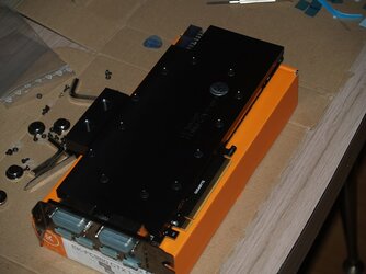

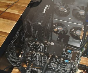

Waterblocks being fitted to the GPUs.

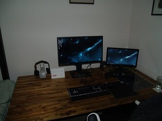

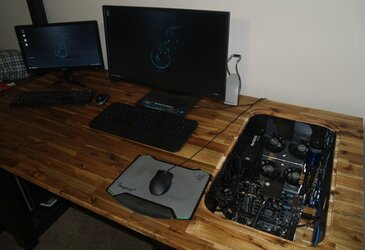

And all done. The small monitor needs to go. I'm swaying between a second 27", a 40", or a 34" widescreen at the moment. It's very handy to have the second screen though, especially when running VMs. So I think a multi monitor stand will be the way to go, maybe throw one up above the main display.
I'm super happy with how this turned out. It runs near silent, the only noise is a slight wine from the water pump. I can fold all night during winter & the GPU temps never get above 42c, I wish I could fit the 540 radiators in more cases!

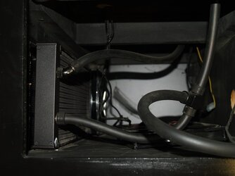

I would like to see a few shots of the rad mountings.

It's kind of difficult to get to the bracket, it's pretty well hidden. I just used a piece of 1-1/2" x 1-1/2" aluminium angle & cut it out on one side so it wouldn't block airflow. I then used the standard radiator mount points to screw it on. It's pretty solid. I gave it a bit of a clean tonight & had the fans out, you can sort of see it under the radiator.

The wood is an acacia laminate. It was good to work with & has a great finish with just wood oil, no staining at all.
I have noticed a bit of expansion in summer, but nothing too dramatic & it hasn't caused any issues.
