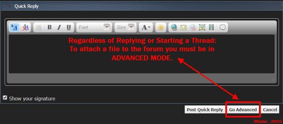

THIS is the long version with Pictures...
...How to attach files/images/etc to the forum. This is for the current forum version and not an older forum version.
I think (make that hope) the images tell the story.
RGone...
NOW if you want to link a user to this 'how-to', you can use the URL shown below.
http://www.overclockers.com/forums/...r-Piledriver?p=7812026&viewfull=1#post7812026
