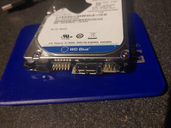

I decided to crack it open. It's a typical WD blue with the silly micro USB connector. I was hoping there was an adapter inside the cashing that could be disconnected with the drive being a typical 2.5" lappy drive. MEH
I remember seeing a drive similar to that & what we are seeing in the picture was the adapter with standard sata/power connectors under it. You might what to look closer & see if there's an adapter to remove.
Unfortunately it is a USB connector and not SATA. This is done to prevent people from shucking lower cost external drives for use internally. Not every external drive does this but more and more do.

There is no adapter. I didn't take a pic of the other side but it's soldered to the drives PCB.
That's definitely a USB connector (USB 3.0 Micro-B) and not SATA. It looks like I can get a replacement cable for ~$7. I'd rather not spend the money on something I'll probably never need again but if that's what it is then I guess it's worth it...plus It's only $7. I've spent more than that on a single beer. Lol
