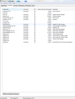

I did my best to get rid a bloatware and i am still having stutter even when most of my resources are not in use
