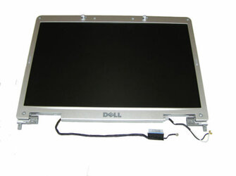

installed the new inverter. for abit i thought it was fixed. somereason i was having difficulties getting windows to load but screen stayed on. then after abit it finally started happening again.got ticked off and put it aside. well its 3am and im wide awake and cant sleep. decided well lets take a look at it again. its been displaying the screen for only about 2 seconds before going blank. something i noticed was it makes a noise that goes away soon as the screen turns off. sounded kinda like bad fan or something so i disassembled it to inspect. because the wires are soo short i honestly cant decide if the noise is coming from the screen or the mobo but if i have the screen disconnected then the noise is gone. well i decided its finally time to find some adapters and an old vga cable to connect it to a monitor. works perfectly on the monitor and no noise. im gonna mess with it more tomarrow its almsot 5am now
looked at it some more this morning. tried swapping the old inverter in and the noise isnt there but the screen stays on only half as long. also i tried looking at the screen with a brighter light and it is actually jsut the backlight is off. jsut have to look at a specific angle. i went ahread and said screw it and ordered a new lcd and another inverter
i ordered a brand new entire upper lid with lcd and inverter. was like 40$ so it cost me same amount as a new lcd, inverter, and lamp would but without screwing with any of if. got it installed little while ago and its working great. the noise is no longer there and it hasent had an issue with shutting off yet. so far im thinking its successful
