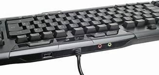

I use the Logitech G110 and it has a USB port on the back to plug stuff in, I plug my unifying receiver for my Logitech M570 trackball with no problems. I do have 2 wireless mice where I had the receiver plugged in the back to the MB and had the same problems with stuttering years ago.
