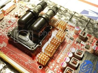

Flip the waterblock over and add 1 fiber washer and 1 nylon washer as shown in the following photo. Put the waterblock aside, for now we go onto the video card.

With the waterblock in place hold the card up to a light source and look at the space between the card and the waterblock. You should see the waterblock and the gpu making good contact. If they are not then you might have gotten too thick of spacers. If I had to do mine over I would have probably used rubber washers in place of the nylon. It would give you a little more play in how snug you can get the waterblock and gpu together. I have a little bit of light showing but that could mean that I need to lap my waterblock.

With thermal past applied and the waterblock in place, carefully turn the video card back over and put a fiber washer and nut over the exposed screws. Put the fiber washer under the nut so you don't short your board. Finger tighten these only. I would not suggest using a wrench to tighten them as this may crack something.

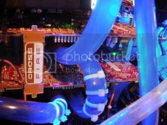

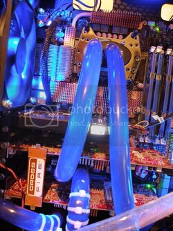

Install your card. Hookup the watercooling. Cross your fingers. Enjoy
Post Mod:
I have done this on both of my cards and they are both currently working great. I have not had a chance to do much overclocking yet but they are staying nice and cool at idle. I have the Sapphire 4770s. The next step is to flash them with the Asus bios so I can mess with voltages. I also want to remove the Sapphire name plate cover the voltage regulator chips and put some better cooling on them. The plate is only held on with thermal tape so it pops right off. You can feel some heat coming off it when you touch it. The memory heatsinks are also slightly warm so without a fan blowing on them they probably need something on them.
