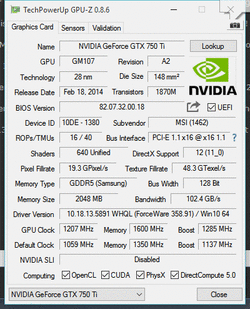

But here's the strange bit. The core clock is not boosting to 1285MHz but 1363MHz under heavy load! The Core Voltage increase is still set to 0.
At other times it is dropping as low as 135MHz or 1085MHz depending on the load which is fine as I would hope it would remain variable depending on requirements.
But I cannot make it boost to the settings I have in Afterburner. It's always a lot higher.
If I alter the memory frequency (down) then the max core clock will also be a bit lower, but still not 1285MHz as per the settings.
GPU-Z confirms that the settings are as per Afterburner. But during games or when running Furmark the core clock is going to 1363MHz.
I even increased the core clock boost to 1300MHz and got a reading of 1400MHz under heavy load. It was still stable, but I'm a little concerned as to why it is going above the settings to such an extent.
Does anyone know what's going on?
Thanks.
