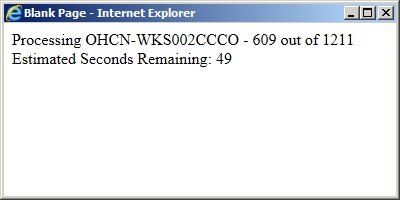

- Parent script creates progress window, showing estimated seconds remaining until all machines are complete.

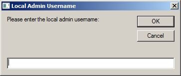

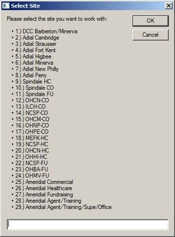

The parent script can just be doubleclicked, and it will display popups to get required input.

The contents of the progress window update constantly in real time:
