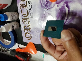

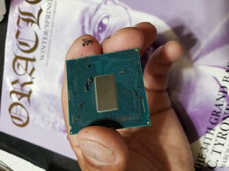

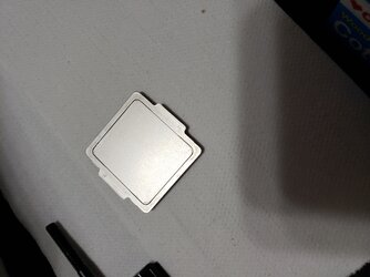

A few days ago I decided to delid my 8700k. I used a cheap $12 BoArt CPU Delid Tool and it worked just fine. I also didn't reseal as it seems the general interwebs consensus is that no matter how little you apply it does raise temps so my Gigabyte z370 Aorus Gaming WiFi board is holding it clamped in just fine. Before delid, running Aida64 I was getting max temps of 95°C on 4.9GHz using the Gigabyte pre-made overclock settings on a corsair H115i extreme (push/pull) for cooling inside of my Antec 1200 case. After delidding and applying Thermal grizzly Conductonaut liquid metal to the chip and covering, Thermal grizzly Kryonaut to the cooler I now max out at 72°C running at 4.9GHz. I absolutely didn't expect a 23°C drop! Currently I'm on 5GHz on pre-made overclock settings getting and max temps are 77°C.
My PC is quiet as a mouse now but when PLEX does an analysis run I do have my side fan set to kick up to max speed to cool my VRM as these Gigabyte boards seem to have a heating issue w/ VRM temps. I've gone as high as 125°C so now using this side fan it seems to top off at 111°C. The side fan is fairly good and silent so it's not much of a sound issue thankfully.

I'm surprised it works without a delid kit for the motherboard. Be careful kn that clamping force on a naked die.....the risk to run naked versus its returns is too much for me.
DaPoets
DaPoets
Aug 23, 2007
I guess I'm not sure what you mean by it working without a delid kit for the motherboard.... and it's not "naked" as the covering is on it, I just didn't apply the "glue" to reseal it as my research shows a lot of people ended up deliding again and not using the sealant compound the 2nd time around for better temps since the motherboard holds it in place just fine.
