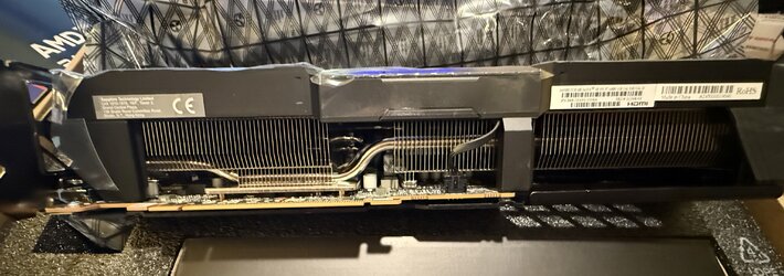

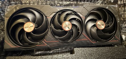

I got my Saphire 9070XT in today and finished putting it in and went to wire its power plugs and ill be damned if i only had 1 8pin cable. i had to use one on my mobo and that left me short.
to top it off im broke says my debit card. i have a way and im gonna try and get one here asap. Ill post pics later as im to pissed to mess with them now.
anyone know if this is the 8 pin plug i need for my GPU?

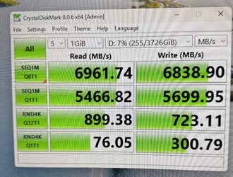

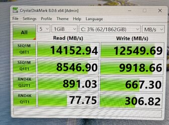

This is a bench of my Corsair T705 2TB
The second one is my Corsair T500 4TB
The 3rd is my T705 again on Diskmark

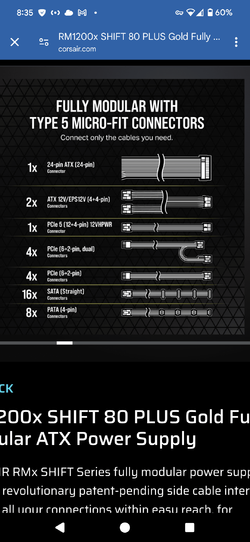

That power supply should have multiple 8pins. The specs says it came with 8 pcie connectors
Are you looking at the CPU cable which is different from pcie?

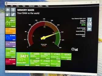

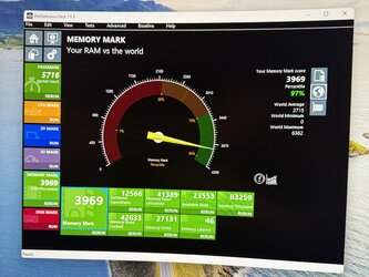

The first bench is my 6000Mhz CL30 ram 32GB stock speeds.

3rd is my new Sapphire 9070XT i cant use as i need another cable to power it.
The fourth pic is my ram OC'd too 6400Mhz CL32 and it flew!

it has room to plug them in just not enough cables, It was a refurb so its hard to say just what is missing. Says "Type 5" on the psu plug on the 1 i have.
Think the one i linked will work?

Dang man i dont know what i need, I just know i need a GPU 8pin plug and the psu end says Type5. its like a small 8 pin on 5the psu side.
It looks like the second cable down.
Maybe take a picture of what all you have left for the cables? They are almost certainly going to be 6+2 pin cables.
I wouldn't be touching those chinesium cables with a 10 foot pole. Where did you get that power supply from? Refurb or not it should have come with every cable. The website I linked is the official page with the number of every one of the cables that were to come with it.
If you do indeed have the 1200w power supply every one of those should be accounted for. And I'd personally use the straight 6+2 pin without the adjoined dual connector, but even using the duals would be fine (I prefer not to use the secondary attached ones)
yes one is powering the mobo and i have the one for the PSU, Ill look for a 6+2 and that may work or at least cause a fire.
The PSU was like new from Amazon but almost half price. Its a beast and ive only seen the fan on once.
EDIT: ok i found two 6+2 connectors that say PCIe on the psu end. do it and pray?
ok i take it that im set to go. Ive never owned a card that had anything over a 4 pin molex back many years ago.
Nothing to pray about, those are the correct cables. The 8pin that are 4+4 are absolutely the wrong cables and would prob have burnt out your card like ED said.

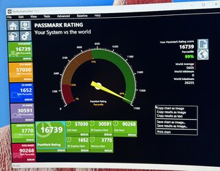

My last bit of fun for the night, I wish i could get PCMark running. Everything is stock when i benched it but my ram was tweaked from 6000Mhz too 6200Mhz
once this thing is fully OC'd it should be wild.
