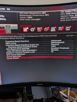

Interesting find this morning. In a MSI bios there are two separate locations to access PBO...one in Settings and the other in the OC tab. The problem with that is one will override the other...they don't speak to one another despite the format/settings being identical. It was a real head scratcher why my bios changes were not showing up in tests until I figured this out.
I barely used any AM5/MSI mobo, but I assume this is the same as on every other AMD mobo brand. Each mobo manufacturer has its own OC tab, and there is also a "standard" AMD OC tab. Both have most of the same settings, but not all. Those who buy a cheaper mobo that lacks manufacturer's options can still find some OC options in the AMD OC tab.
I noticed that on some brands, not everything works, or some options override others. On the other hand, the list is long, but most options are useless.
Indeed it is. There's typically TWO ways to access that. Never playing with it, I THOUGHT that they would be in sync with each other, not one working and one not, lol. That's odd to me.

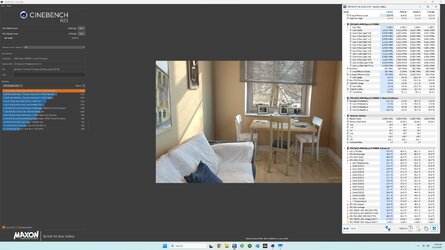

As suspected, it looks like your temp limit is putting a glass ceiling on performance (~3% from 75-95C) with these settings. I also suspect once you put the negative offset back on the scores will be closer.
It makes sense there isn't a change in gaming as the temps likely aren't reaching these levels/where it 'throttles' in the first place... that or it doesn't need the extra 3% it's getting. Did you test COD at 1080p(cpu bound) or 4k(gpu-bound)?

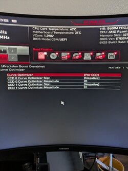

PBO is set to Advanced, motherboard, + 200Mhz and - 20 both CCD's. I use a 1440p monitor so I did not test any other resolutions. You can see the increments in the Cinebench scores at each thermal limit. Verifies the absence of any gains/losses in games, but then again I'm only looking at FPS numbers and thermals.
-20............mv?
1440p uses less CPU than 1080p, so that jives.

Short answer is, yes, that is for voltage (I had to look it up, lol).
Why do you change voltage here, and adaptive? Why not just use this to reduce voltage?
Not certain I understand your question. Are you asking about the vcore? I have done next to nothing yet on this dual CCD cpu when it comes to the Curve Optimizer or Curve Shaper.
Yes.
That's what that setting does is lower your Vcore. Then, I think it was you (this thread is mess, lol), you change the adaptive voltage too?
Yes.
I think you are limited as to how much you can do in the optimizer...like if I tried -30 it might not boot. Setting the vcore voltage manually seemed more predictable to me and it still adapts...just limited to my exact specification. I would have to run each and watch it in HWINFO to compare. At any rate, my vcore voltage is now set to auto. I still need to test the effects of CCD vs all core vs per core on this cpu to see what works best.
Is it not as granular? You increments are 10/20/30 etc? Increments of 10, versus when using adaptative you can set it to whatever?

Don't copy the numbers on my screens. Stumble around until you find Precision Boost Overdrive and do this -
Precision Boost Overdrive - Advanced
PBO Limits - Motherboard
Precision Boost Overdrive Scalar - x10
CPU Boost Clock Override - Positive
Max CPU Boost Clock Override - 200 (This is all it will allow)
Platform Thermal Throttle Control - Auto
Leave everything else alone, F10 to save settings and exit. Test the difference. If all is well the next time you enter bios save your current settings in a profile and name it something you recognize...like PBO-1. Every time you make a change in bios do this so in case of a failure to boot or a crash all you have to do is load that profile instead of jumping all around the bios trying to remember what settings you had last that were stable. Take a screenshot of those bios settings if you think of it. Once you get this foundation set you can then move on to Curve Optimizer and/or Curve Shaper.
