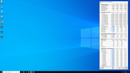

its a bit of boost, what do i change to go higher another 100MHZ? once i have that ill put my ram back into its settings.
2 birds with one stoner, eeeerm i mean stone.
i got the 200Mhz OC and kept my Ram at 6400Mhz 1:1 stock timings.
Now to stress test the hell out of it.
Id still like another 100Mhz if my temps hold out.

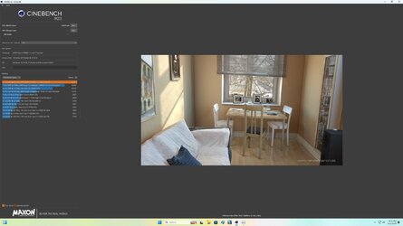

Start a guide on the 9070XT as its soon to be next.
Thanks guys really, I couldnt have gotten this far without you.
So, you jumped right into both, again. If it's your intent to ignore what you said you were going to do, then cool. :)
If not, let me clarify....
You need to make sure your CPU is stable... I don't know what your idea is of stable, but before I'd move on to RAM I'd make sure you get two hours out of it.... whatever you want, that's just me.
That said, once I found that stable, I'd STILL GO BACK TO STOCK and work on the RAM alone. Once the RAM tests stable for a couple of hours, THEN I'd enable the CPU tweaks and stress test both.
As it stands, if something went wrong, you'd still have no idea what caused the problem.
How are you going to know what the error is and why?
You'll know it ****** up, but why.

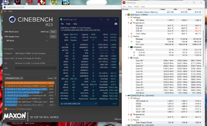

I ran a few tests for stability and temp control and then went back in and added my last know ram settings that worked. From previous testing this ram wont budge past what is stated on the box.
Yes im doing this wrong, BUT if i do get an error i can go back and do as told. So far no errors and i put the smack down on Elcos CB R23 score.
I cant go higher on the cpu unless i can undervolt it as it hangs at 90-91C and even popped 95.5C once.
I understand the way im doing this isnt the scientific way but a short cut, But i can always go back and easily find whats causing the issue. ill be stress testing these settings for days.

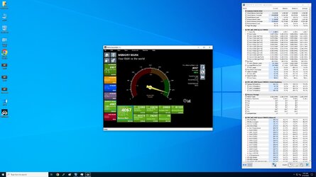

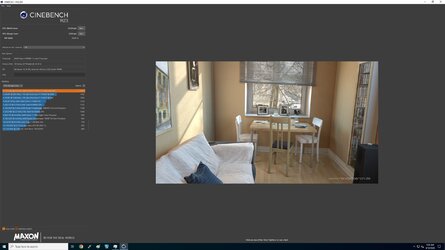

I run PBO advanced, manual, PPT 280, TDC 180, EDC 200, +200MHz, all core -28.
That should get you up to my level.. maybe.
Just ran a Cinebench and got 33760 so im on the right track.
Ill try Elcos curve optimizer and bench it and then reset my bios and attempt what freeagent said.
Can you guys tell me what the changes you suggest do? and yes ill back my memory off to attempt these settings.

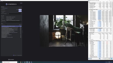

Go back to bios and open Curve Optimizer...first try -20 on both CCD's to see what the results are.
not sure what results to look for on this one, But is staying stable under Prime 95
Edit. I found the FSB and messing with it and memory speeds since it multiplies those setting.

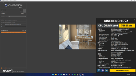

I believe i just surpassed your score and im going back in and pushing a bit more. Temps be crazy, If they were ingame temps id be looking for a new AIO that can handle 350W+
See post # 335...screw the memory **** for now.
You Photshopped that score man, I can see the pixels! honestly my cpu would melt being pushed that hard.
Im taking it 1 more Mhz up and done.
Unless you know where i can grab a few more Mhz?
dang man thats high, You gotta show me more later pls.

how are you getting your clocks so high?
It says 4.4ghz but ive had 4.45Ghz and still be 200 point under you.
Everything seems on par as to what im getting, Except that 36k score is awesome. I gotta find the settings that let me OC more than 200Mhz
