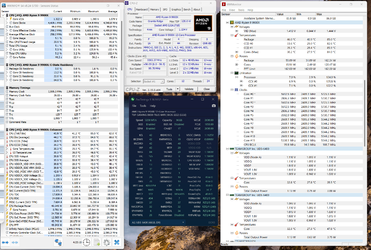

I have them both, and HWMonitor is reporting it hit 102.1Mhz on the BCLK
my system is stable running smallest tft's in Prime.

There's always some float (called spread spectrum), but it's typically 1-2 mhz. 115 is an odd reading.
You can also confirm with CPUz.
I just stopped Prime and HWM hit 102Mhz but HWI64 reported no such activity.
I mainly use it for temps anyhow, Why its so buggy i dont know as im passing every test i throw at it.
My question would be why bother with Monitor when you have HWINFO64? Unless someone else can verify this "float" in Monitor in actual use I have to believe you have some bad numbers entered somewhere in your bios.
I suppose it is easier to find and read the info on sensors im looking for.
My ram is set too EXPO. PBO is set to positive 200 and the curve optimizer is negative 20 on all cores. Thats all i use settings wise.
Something about my system HWM doesnt jive with, Its not just the BCLK acting up but my MHZ go screwy too.
Ill run prime and run both monitors and see whats real or not.
Mine stays pinned at 100MHz, no deviation at all.
Same here on three different cpu's. I have heard for years complaints about flaky info being displayed in Monitor which is why I never use it. Betting if Death installed it on his laptop it would be pinned at 100MHz as well. Set bios to default values and run it again.

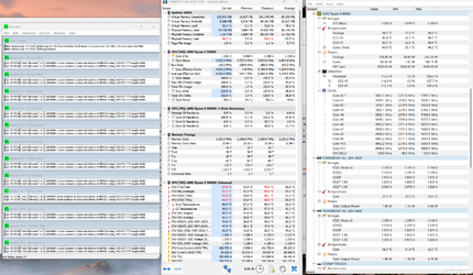

as you can see just after 5 minutes its giving odd readings on the BCLK

ok i put everything stock except i enabled EXPO. I ran Prime about an hour and you can see the BCLK discrepancy also.
Ill leave it stock for a while as i like the lower temps as 200MHZ is only gonna show up in benchmarks.

No, I suppose i didnt.
Ill do it tomorrow and post the results. From what i can tell its just HWM is flaky on my system.
Why put so much time in one an issue that doesnt matter.
The point was that the issue appears only to affect you. Using complete default bios settings would better isolate the problem. It may be just me, but I would not trust any installed program that is obviously spewing out bogus information/values. Are we to just pick and choose what values are actually valid/truthful?

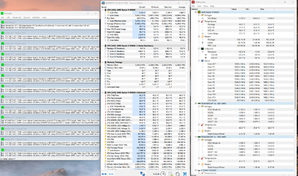

Ok ill get it set and run prime a few hours.

Im rerunning all those test so hopefully we can see a difference in a few hours.
still same results on the BCLK and slight differences in many places.
