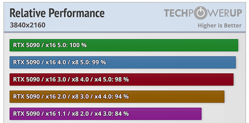

Id really like to add this card but read the bifurcation to the PCI lanes could hurt my GPU's performance.
I think we went over that before too... it's by a whopping 1-2% (google TPU PCIe scaling rtx 5090). It's how I run.... (5.0 x8). ;)
I dont think i fully understand that, Got a crayon to explain it it more simple terms?
Id just face loosing 1-2% on the GPU? ill google that now.
i read Techpowerup's testing and watched a video. If im reading this right its a 1-2% drop to run at 8X so id really never see the drop.
What i didnt see was Gen5 x16 FPS but im sure thats easy enough to find.

It was there... in all of them. That was the 100% value.... says so right on it, even.
The point to show you the info was for knowledge, not to get you to switch, lol. You're all walking around the world worried that you'd lose significant performance and it just isn't so....
