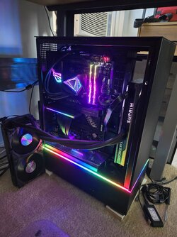

First... the case/build.
The Lian SUP01 is an interesting case. The GPU mounting is particularly unique with it being mounted in the front, IO side down. You route the display cable (in my case 2x DP) in the case and into the GPUs IO... I suggest you routing the cables and connecting them BEFORE you mount the GPU. Outside of that, even with the 3x120mm AIO and 3x120mm (inlcuded) fans, there's not a ton of airflow. That said, the hottest temps the CPU reached at stock during gaming was 75C, and banged off the limiter eventually in any stress testing.

That case is weird. Also not used to seeing a GPU with an AIO, so that is weird too :D

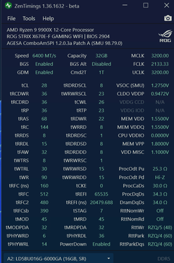

1.4 VSOC seems a tad.. high, not like snoop dog high either. I have mine at 1.275 for 6400 1:1, with 2133FCLK.
Is that ram on the QVL? The board seems unhappy with your memory choice..
Edit:
Biggest help for higher mem speed was VDDG IOD to 1.060 and that fixed me right up. Couldnt go past 6200 stable without.

I'm unsure if there is any magic in 6200-6400 1:1 besides the mobo model and IMC quality. For mobo reviews, I literally install my 96GB 6400 kit on any mobo, enable XMP, and it runs or not. I don't adjust any voltages - mobos do that automatically (or can't post). The same on ASRock X870/X870E/B850, Gigabyte X870E/B850/B650E and ASUS B650E. I had no 800 series ASUS. Most B850 models couldn't run at 6400 but could make 6200 1:1. I don't expect ASUS X870E to have problems with that, so it's either the BIOS version or IMC. I also haven't seen many CPUs that couldn't make it, so have to be really unlucky to get one.
