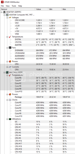

So here's my Project
Here's my patient
I'm looking to transform & perform one hell of an operation on.
Current Build
Current Air cooling Temps
Following Spreadsheet link has all items listed of what is going to be installed.
