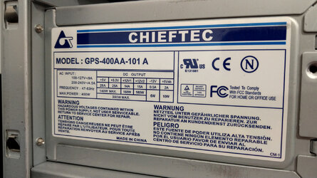

Can you post an image of the label that shows the power breakdown? I'm assuming it's this one... ~340W available max in 12V....its old on top of jt... id look there sooner than later.

You right, its that one.
