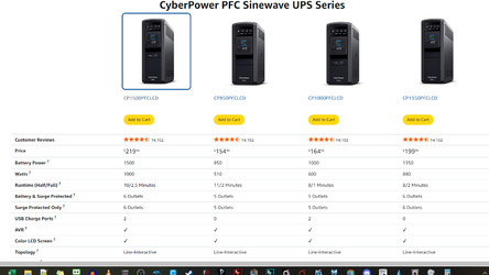

I've been using a CyberPower CP1350PFCLCD on my desktop without any issue. The 1500 is also only $20 more on Amazon right now.
Are you referring to this one?
I've had some long term reliability issues with apc and cyber power ups (I have 4 ups in my house). After one died I decided to get an Eaton as they're generally well recommended. https://a.co/d/2vzgRYd
Sorry to hear that, and ty for your recommendation!
