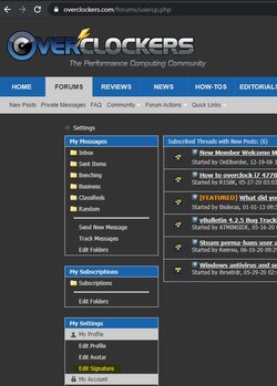

You should make a signature with your full systems specs for us to help you out better like the one Trents and I have below our posts.
Follow the steps in the attached images.
