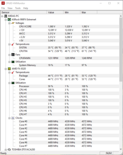

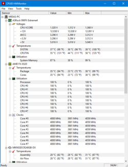

Here are the results from the test at 4.0ghz. Could somebody tell me what exactly to be looking for so I don't have to come here and post these every time I run a stress test?
4.0ghz HWMonitor.png 4.0ghz CPUZ CPU.png 4.0ghz CPUZ Mem.png 4.0ghz CPUZ Spd1.png
And here are the results at 4.5ghz and 1.425 volts.
4.49ghz HWMonitor.png 4.49ghz CPUZ CPU.png 4.49ghz CPUZ Mem.png 4.49ghz CPUZ Spd1.png

2 hours of Prime95/OCCT/Aida64 or 10 runs of IntelBurnTest 2.54 is usually enough for everything except the most intensive stuff (h265 encoding, number crunching, mining and whatnot) you might want to throw at it. If it passes, go further. If your rig goes up in flames you went too far ;)
Daniel,
Just looking at the temps you are pretty much maxed out and I don't think there is enough temperature headroom to get to 4.6 since that would likely require more vcore which would produce more heat.
If you can pass Prime95 for two hours you can be confident that you are stable for your purposes. If you can't pass the two hour test then add .01 more to the vcore and you should be good to go.
