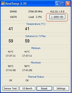

below are the screenshots you requested so far no errors in small FFTs will test blend in a bit pc health status says my core voltage is Vcore 1.380V, everything in the M.I.T. MB Intelligent tweaker is on auto i circled my VID in red just incase

been running prime95 blend test for the past 6 hours using the info in the pictures so far no errors and max temp at full load is 54c if i can figure out a way to lower the Vcore for my cpu as well as work on the ram timing all would be well but i will not adjust anything unless you guys tell me to adjust it
That VID reading in Core Temp and Real Temp isn't your current CPU Voltage by the way, that is just the stock voltage as reported by the CPU (what is programmed into it at the factory).
I don't know if that was clear to you or not, as in previous posts you were asking which one to look at.
im afraid if i push 4ghz that my voltage will go to high and either burn out the vrm's or the cpu or psu also seeing as how coretemp reports my vid as 1.3000v i dont think i can go lower then that unless im mistaken
Going below the stock voltage is quite possible, and not a problem as long as the CPU is stable at whatever voltage it is given. On one of my E8400 E0 stepping chips I was running it at 1.1v while overclocked to 3.5GHz even though my stock voltage was 1.2625v. Depends on the CPU, some CPU's can accept running at a voltage sometimes far below the stock voltage while remaining stable.

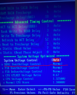

I'm confusing myself now it seems. But I find this interesting from Kaitlin's post #39. Apparently the bios automatically overvolts the RAM when overclocking. I can't remember ever seeing this setting in a bios before. In my experience Auto overclocking wizzards usually downclock the RAM. It's cheap Nanya RAM too. It's doing rather well.
Kaitlin, gives us a shot from the bios tab screen that shows running voltages, fan speeds, temps, etc. PC Health tab?

trents all options for overclocking in the bios are set to auto the only option set to manual is the FSB which i have set at 9x412

You didnt touch your cpu voltage?? It was on auto as well????? Its supposed to be done on manual...it is a basic premise of the guide!!!!!!!! Auto tends to use more voltage than needed which is why all guides say to do it manually.
You have to change that system voltage control to manual, then you can adjust voltages.
