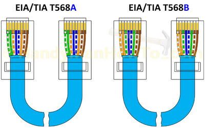

Are you wiring with A or B standard? Maybe try the other?

All you need is a basic tester to validate continuity (something like this). Most likely, you only have two pair doing it's thing. You need all four pair for gigabit. A/B standard doesn't matter provided they're terminated the same on both ends.

i followed the B pattern but as said it shyould not matter as i have done both ends the same.

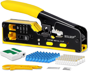

the crimp tool kit inclueded a basic tester similar to Railgun posted, the kit i used was this. and it verified all pins had connection and were in proper order.
