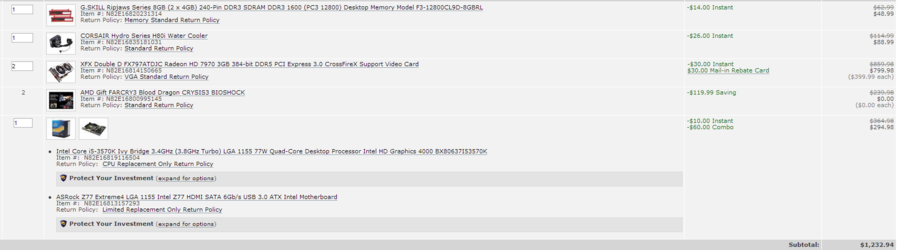

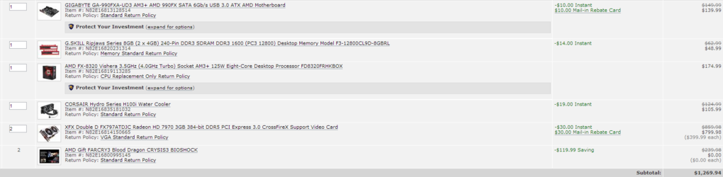

If you plan on staying with the AMD build I suggest going with the 7950's you said instead of the 7850's. Also only get 2x4g of Ram if you can get away with 8g of Ram. If planning on benching, 4 sticks will put a greater stress on the IMC and can limit your OC.
Personally, I would have gone Intel as I don't believe in being "fans" of a corporation and getting nearly the same performance for about $40 cheaper, but it's your call.
