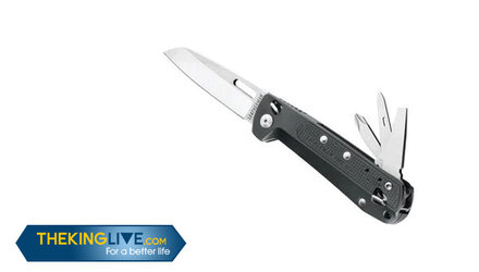

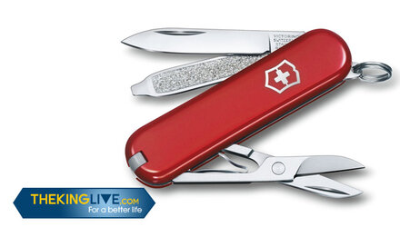

1. Choose the right number of blades
For first-time buyers, getting confused with various types of blades is inevitable. So our tip is do not get bogged down on these categorisations, as there are basically two key types of pocket knives: single-blade and multi-blade. If you’re keen on a compact, lightweight model, go with the former as they’re usually designed with great simplicity and convenient size. More importantly, most of them have unique locking mechanisms that ensure they are sturdier for demanding tasks.
Multi-blade pocket knives give you the variety of three or four blades to handle different jobs in one tool. The best Pocket knife reviews always include both models in their list, so you will not face any difficulties picking either a single-blade or multi-blade pocket knife of your choice. What if you need more than just a knife in your pocket? Well, Swiss Army Knife is one of the best pocket knives in the world that include a blade, tweezers, can openers, scissors, corkscrews, just to name a few.
