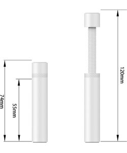

Damn something that didn't cross my mind was the weight of the card. Read reviews that some people reported broken PCB's with these Gigabyte cards. Would a standard support bracket like this be sufficient? 🤔

do you have a 3d printer, or friend with a 3d printer?
I would just make and print one myself if it was me.
I've always wanted to play around with a 3D printer, maybe that is what I should buy next. Can my video card handle 3D modeling 😁
Yes it can.
Post magically merged:
Can you take a picture of the GPU (or a GPU) in the slot on the motherboard, Its also possible that you could make a support arm with something like Plexiglases so it wont disrupt your design.
I mean, don't transport it with the GPU in there and make sure it's secured to the case and that won't happen. ;)
Many large GPUs come with support struts already.

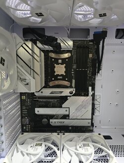

It's Alive...
It is slow on startup and restarts 🤔

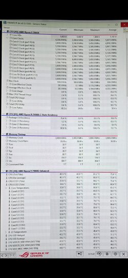

No PBO under-volting yet, but just saw my tenp hit 95° starting up Cinebench 2024. 😬. Went back to idle 45°.
Running Single Core Test at a steady 68°. Final score was 119.
Running Multi Core Test at a steady 92° without thermal throttling. Final score was 1615.
Hmm just tried a negative 25 under-volt and had no effect. Tried ECO mode just to test and wouldn't boot to Windows, just got a black screen after Asus Logo 🤔

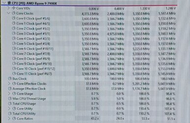

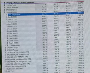

Now moved to PBO Enhancement Mode Level 2 with a Curve Optimizer of -25. All Cores hitting 5400mhz and CoreTemps 80-81 running OCCT. Wierd thought that now HWiNFO showing random RED temps in CPU (Tct/Tdie), CPU Die (average), and CPU CCD1 & CCD2 (Tdie). No thermal throttling!
These CPUs are designed to use the whole available temperature range. I assume you used one of the PBO profiles with a lower temperature limit (80°C ?), and that's why it reaches slightly above that and shows red. The standard limit for the 7900X is 95°C. All my Ryzens go up to this temperature without throttling except for the 7800X3D, which has a lower limit. In my meaning, throttling is when the CPU works slower than the default settings. Hwinfo64 won't show the throttling unless the CPU has forced lower than standard frequency or limited power. For the 7900X, the base frequency is 4.7GHz, so if it runs at less than 4.7GHz under load (and it's not manually forced frequency), it has some problems. Your CPU runs at 5.4GHz, so there is no problem. It actually runs higher than most of those CPUs. The average max on all cores is around 5.2-5.3GHz.
OK thanks for the info, but what do you think of my results? That's the best I found for temp / frequency.
It looks great :thup: I don't think you can make much more out of that, as it's already better than most others can make on these CPUs.
