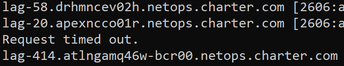

After some more testing, it's just youtube and google that run slowly. Images on bing and videos on vimeo load fine. Comparing to my old laptop, youtube videos run about 1/4th the speed though. Could my ISP be throttling google stuff? But then if it was my ISP, I guess my other laptop would go slowly too. I'm very confused.
Any idea what these are?

Those look like nodes inside Charter's network. It SHOULDN'T be an issue, though. Do you have your own wifi router or are you using their supplied wifi router? Also, just out of curiosity, do you get the same results from private/incognito mode? With you seeing this on the 2 major browsers, I'm inclined to rule out browser settings/cache, but just curious.
Last check is to try rebooting your router. Granted only google-related network traffic is affected, it could clear out some weird glitch in your wifi connection.
