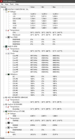

Thanks mandrake I will do a prime blend test tomorrow morning for 20 minutes. I also would like to note I remounted my cooler and found that when I lifted and set down the cold plate on the cpu last time to try to line up the brackets my Diamond Nano thermal past had a bunch of air pockets :shock: . But I took about 45 minutes to thoroughly clean my cpu and cold plate till they were shinny and clean. Reapplied a perfect amount of thermal paste and had my friend help me remount the cooler on, now it its even and on very snug. I ran prime for about 15 minutes and my temps had actually gone down a little over 10C! Who knew a slightly lose cold plate and poor thermal paste could cause such a change! Un fortunately I forgot to screen shot my readings, I will duplicate the test tomorrow and post them here!

Ok thanks and yes a bad mount can really screw up temps.

Ok your temps look good. One thing I notice is you're running your ram at 1866 which you stated in your first post. You may want to do some testing to see if running 1866 @ 11-11-11 is actually faster then running @ 1600 Mhz 9-9-9. How long have you run Prime 95 to see if this Oc is actually stable, 2 hours minimum?
Now as far as running the setup with the power saving features on you need to write down everything you changed to achieve this Oc if it is actually stable. Then set the power savings back on and put the Cpu back to default. At default open Cpu-Z then click on the "About" tab, left click on "save report txt." this will give us the P-States of your chip .ie the voltage it needs to run at stock settings. Then we'll need to just subtract the voltage it needs at stock from the 1.368 you're giving it under load. This will give us the offset voltage you'll need to run with the power saving features on, overclocked. It will look like this.
