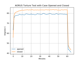

I finally got around to testing the system with the case closed and two 140mm fans exhausting on the top.
Looks like the system is 4C hotter with the case closed. Maybe need one more fan on top...
The case open run was without the two 140mm fans on top.
Both tests were run with 100% load.
Case off is typically going to be better unless you have a super high airflow case (you do not - it's a 'closed' front with mesh vents). Reviews confirm this.
If you were testing temps with the side off/on, the only variable that should change is the side on/off. You changed the fans so the datasets aren't giving you an accurate answer (accurately anyway). In the end, to me, it's not worth a retest, I doubt it would make much of a difference (and that knowledge gains you little), but that's empirical testing.
