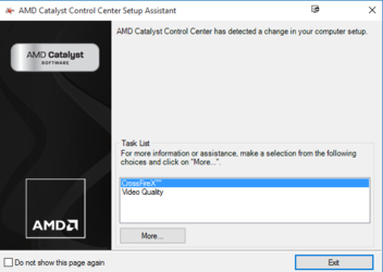

PROBLEM:
Catalyst Control Center won't let me enable Crossfire (picture below). Device manager recognizes both cards.

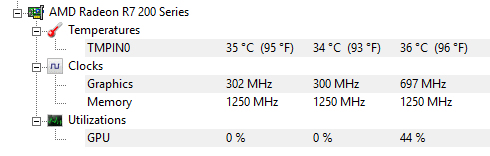

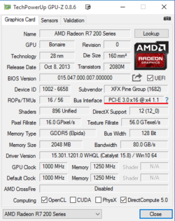

HWiNFO, HWMonitor, GPU-Z:
HWiNFO GPU screens

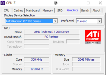

CPU-Z GPU screens
HWMonitor, only recognizing one GPU?

Here is some screens from GPU-Z, I'm not sure if you can tell from those, but it's worth a shot, right? :)
Here is the 'Status' bar from GPU-Z on the SAPPHIRE card
And here for the XFX card

The PCIe bus will drop speed when at idle to save power, that's why it shows @1.1
It could be worth checking out some older drivers after cleaning with DDU

With these drivers only, I've been starting to get this message from CCC at start-up.
Does that mean there's hope?
When I go into Performance > AMD CrossfireX™ I still get the same message from CCC (the one posted in OP).
