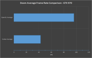

Just sharing what I found in benching with presentmon on Vulkan. First video is about Doom but will have a follow-up video shortly. Also doing more investigating into whether some of what I'm seeing is due to the tool or not. I'm not a video editor or a youtube personality by any means, this is just something I wanted to try so be nice :)
Results start at 2:30

Have no idea what he meant, but from 361.91 OpenGL to 368.69 Vulkan it raised my fps in Doom from ~120 to ~190, so I'm happy with it I suppose ?
Basically that even though your card is rendering the game at 190 fps, there seems to be a bug in Nvidia's Vulkan driver where it is forcing your frame rate to the refresh rate of your monitor (60 fps for a 60 hz monitor) but is dropping frames from not synching correctly. In other words, even though the game is rendered at 190 fps, you're probably averaging closer to ~50 fps from swinging between 60 fps to 0 fps over and over again. For Vulkan games right now, it's better to stick to OpenGL on Nvidia cards.
Roughly the same fps on my screen with every counter i checked, Vulkan slightly in the lead.
Most counters don't work under Vulkan. Also, the other counters will only tell you how many fps are being rendered by your card, not how many are actually being sent to your monitor. You need to use presentmon to see the difference under Vulkan.

It effects Pascal as well. It may be dependent on driver version, I'm looking into it more.

368.81 was driver used for testing, the issue is definitely present with this driver. A German website has tested this and found the same issue.

It's more of a "microstutter" as it has become known as over the years. Basically, even though the fps is telling you it's higher in Vulkan, it's actually higher fps under OpenGL and is a smoother experience as there aren't any dropped frames. I definitely felt the difference when switching but some are more sensitive to it than others.

Yes, it can't match the pid to a game executable. Can you double check the pid after you have doom loaded? If you restart the game the pid will change.
redoing it now, as admin, in a admin command prompt, right PID but still giving off some kind of error ? sent to your email.
Edit: Online guide says i have to download "Visual express Studio" ?
Edit 2: doesn't the image in post #17 work ? "199.5 fps - 60.3 displayed fps" ? i can tell you there's a definitive bump in smoothness from 60fps vSync to off, doesn't feel/look placebo, its the same as going from 30fps to 60fps.
Sorry, got busy this weekend. Your results show the same under win 8.1. You're rendering in the hundreds of fps but your card is only sending 60 fps to your monitor with lots of dropped frames. Vsync under Vulkan is broken AFAIK and causes even worse performance so that's probably why it feels smoother with it off. For Nvidia cards the best thing is still to run OpenGL instead of Vulkan.
