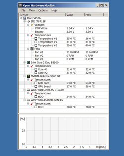

Open Hardware Monitor (Version 0.1.22 Beta)
I am currently developing a free and open source hardware monitoring application. The binaries and source code can be found on the project website http://openhardwaremonitor.org/. Currently it supports Intel Core 2 and i7, AMD 10h family CPUs, mainboards with ITE chip, Nvidia and ATI GPUs and S.M.A.R.T harddisks.
It would be great if a few could give it a try and report any problems, incorrect sensor readings etc. You can report any problems here or as issue on the Google Code page http://code.google.com/p/open-hardware-monitor/.
To report your results, just use "File / Save report" in the Open Hardware Monitor and attach the file OpenHardwareMonitor.Report.txt from the exe folder to your post. Point out anything wrong or missing.

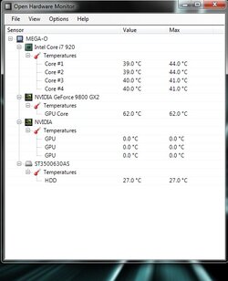

@Nebulous: Could you try the latest version 0.1.2-beta? I have fixed Core i7 temp reading, Nvidia GPU enumeration and added support for the Fintek F71882 chip (which your board uses as far as I know). Fintek detection is still experimental, since I don't have any hardware here.
