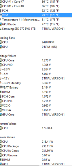

I hit it! 5.1 stable!
So, here's what I did . . .
1. RMAed my MSI ACE MOBO (Wifi was dropping repeatedly while my laptop two feet away would keep the connection).
2. Went back to the boards I know - Asus Maximus XI Formula (MSI ACE wasn't in stock so I'd have to wait for it - decided to go home to Asus).
Settings on MOBO
XMP 2 (3200 Ram).
Bclock @ 100 and Core Ratio @51
Load Line Calibration level 8
Sync Loadline w/ VRM loadline - enabled
CPU current capability 120%
CUP VRM switching Frequency - Manual (500 khr - thank you Asus for the water block on the VRMs)
Power Duty (? can't read my own writing at the moment) CPU - Extreme
Bclk amplitude: 900 mV
Ring - Auto (haven't dialed that in yet)
Bclk aware - Enabled
vCore 1.285
AVX Offset - 0 (I'm testing with non-AVX at the moment. Wanted to get a solid OC outside of AVX, then downtune for it after).
It survived 30 minutes of Prime Small FFTs (but with AVX turned off, again, was wanted to stabilize the reg. overclock before messing with AVX), 20 minutes of OCCT (had to bump the vCore to what you read above from 2.80), and 15 minutes of Real Bench.
For prime, the temps were toasty, in the 90s, but no throttling (see first screen capture). My VRMs are staying right under 50c (SC2). Of course, my ring (uncore) is only 4300, but again, I haven't OCed it yet. I'm planning on running prime for 16 or so hours with a blend just to make sure. But even if it fails, I'm pretty dang happy with where I'm sitting right now.

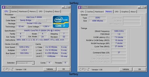

I don't remember a brick wall when I had a Sandy Bridge. I swear that I remember hitting 5.4 gig (but that was probably not stable). I was running benchmarks at 5.2 though.
You don't have to remember it... but it was there!!! We lived it! Its all over the web/OC guides of the time. This was ironed out over a month ago in this thread and doesn't have anything to do with the OP... please stick to the topic. :)
