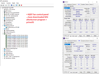

Hi
See the attached picture, I guess it tells more than 'thousand words'?
From Bios those G.Skill -memories should somehow be possible to make run at full speed, before clocking? XMP or something.
From BIOS also I guess I must put on the control of fans - if I remember right I have five fans on PC, and three of them can be controlled from BIOS. I don't know about the last two, though.
As I have air cooled system, not watercool, I think it is quite important to make the system run stable?
I can tell you more later on, but here is perhaps the most important I know at the moment.
Matias
Thanks for the info.
As far as the memory speed... I dont know what your running (on memory tab of cpuz), but yes, enable xmp to get them running at rated speeds.
As far as stable... water or air, keep that chip under 100C. You're just more temperature limited on air. What air cooler?
Your fans... figure out where they are all connected. I set a static speed and leave it... but you can set it different.
Last, I believe we have a haswell overclocking guide... check my signature. :)

My GPU is GeForce GTX 960, it is seen on the image I attached. It is also the question, that how much would it be wise to clock this with Afterburner?
That's old. A cpu upgrade won't help a ton... your gpu is holding you back in gaming.
