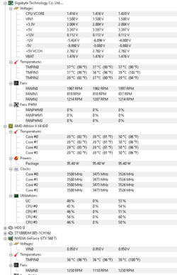

Hey guys, thanks for the replies here's a screen after 20 minutes of prime95 @ 250MHz. I'm a little nervous when increasing the voltage, I don't wanna fry my mobo, not too concerned with frying a 10y.o. processor.
Johan45
Dec 19, 2012
I looks as though your V_Core is getting up to 1.45 under load at present and your temps look good. For these chips 55°C and 1.5v is about where I would stop. Don't worry about the mobo it should handle it.
